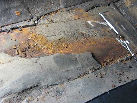

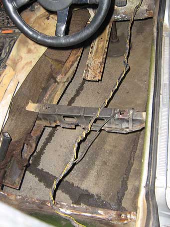

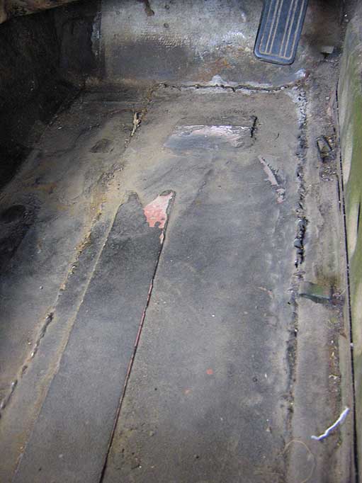

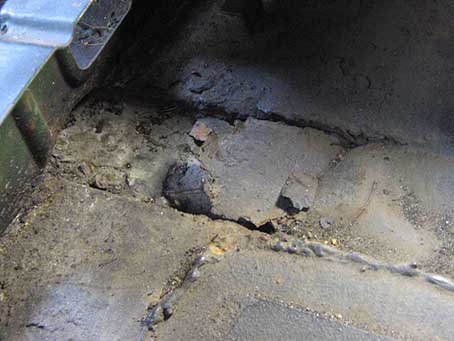

Rod F Posted September 30, 2007 Author Share Posted September 30, 2007 I started work on it yesterday, so far have cut out the old floor and tidied everything up. Need to make some patches for extra areas as well. Photo's show the old floor, and what happens when you simply weld a new sheet of metal over an old one - rust. I also peeled back some sound deadener to find some there as well. I've removed the rear seat mounting brackets and need to remove old metal from them as well. They also needed fixing as they have cracked. Quote Link to comment Share on other sites More sharing options...
Rod F Posted October 3, 2007 Author Share Posted October 3, 2007 Well, tonight I removed the rest of the floor from the rear mounting bracket. I found using an air chisel to be quite effective in carving through the factory spotwelds. As you can see, one of the brackets has cracked quite badly. I welded in a new section of metal for that. The other side will need checking, I might be able to get away with just welding it up. Quote Link to comment Share on other sites More sharing options...
