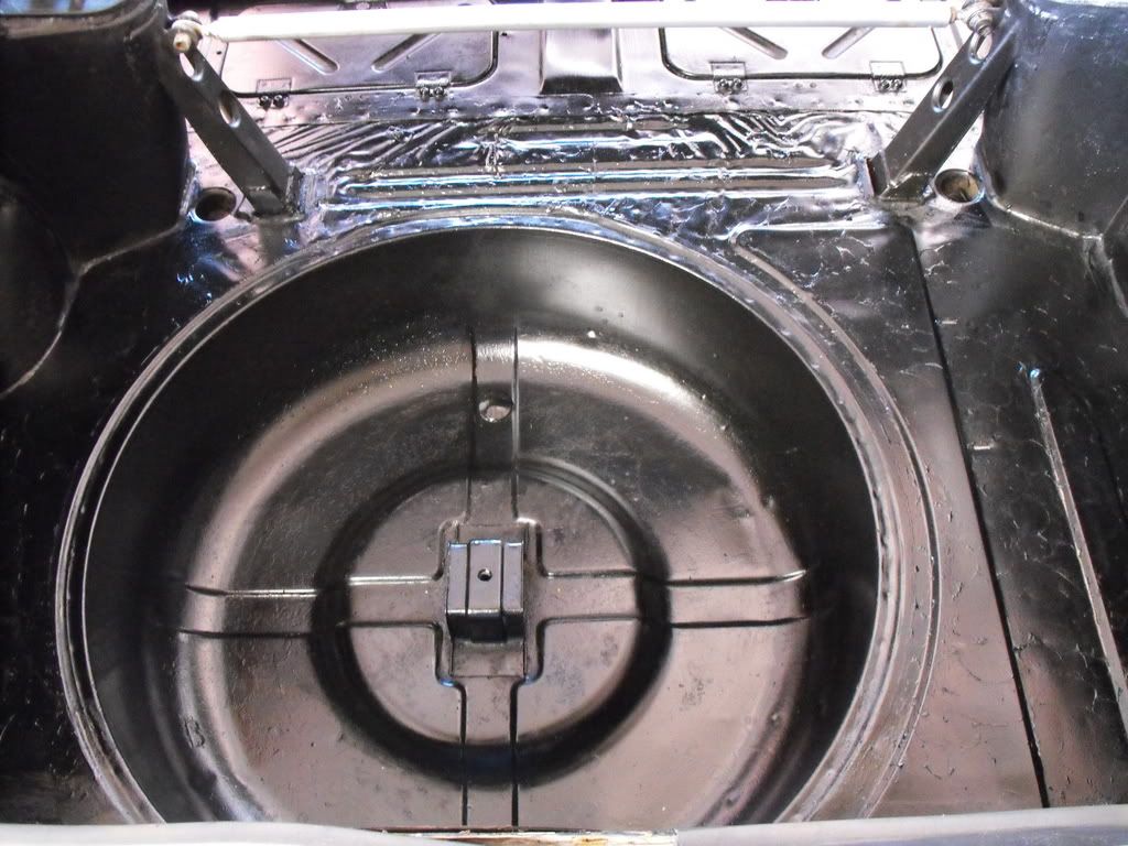

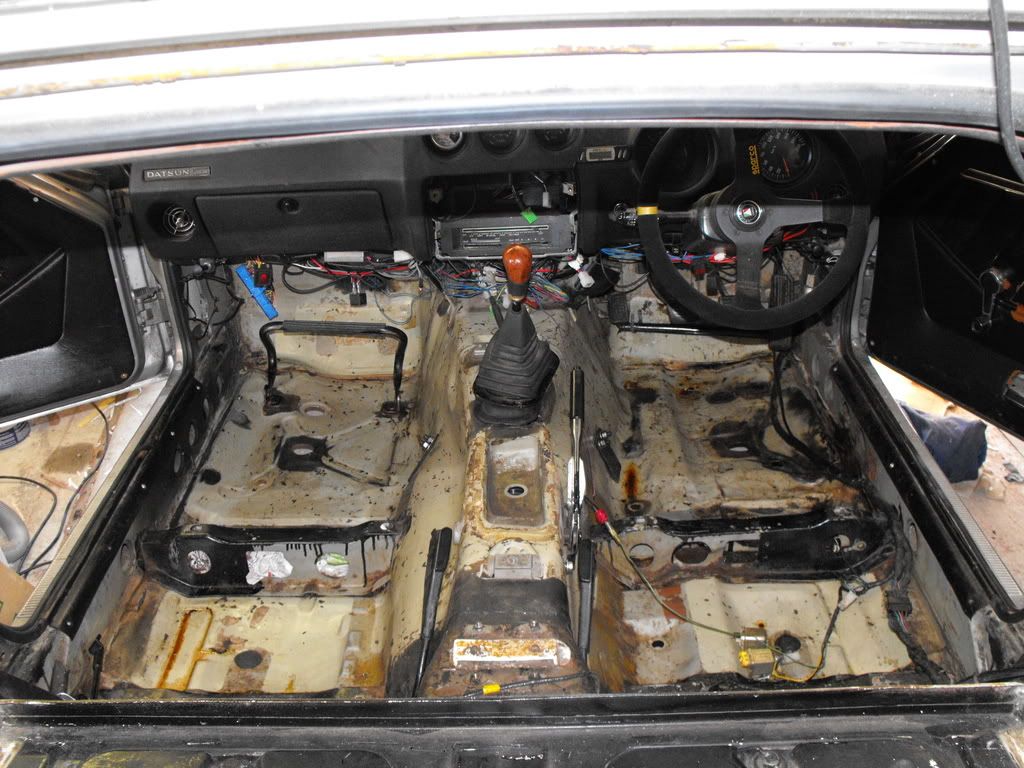

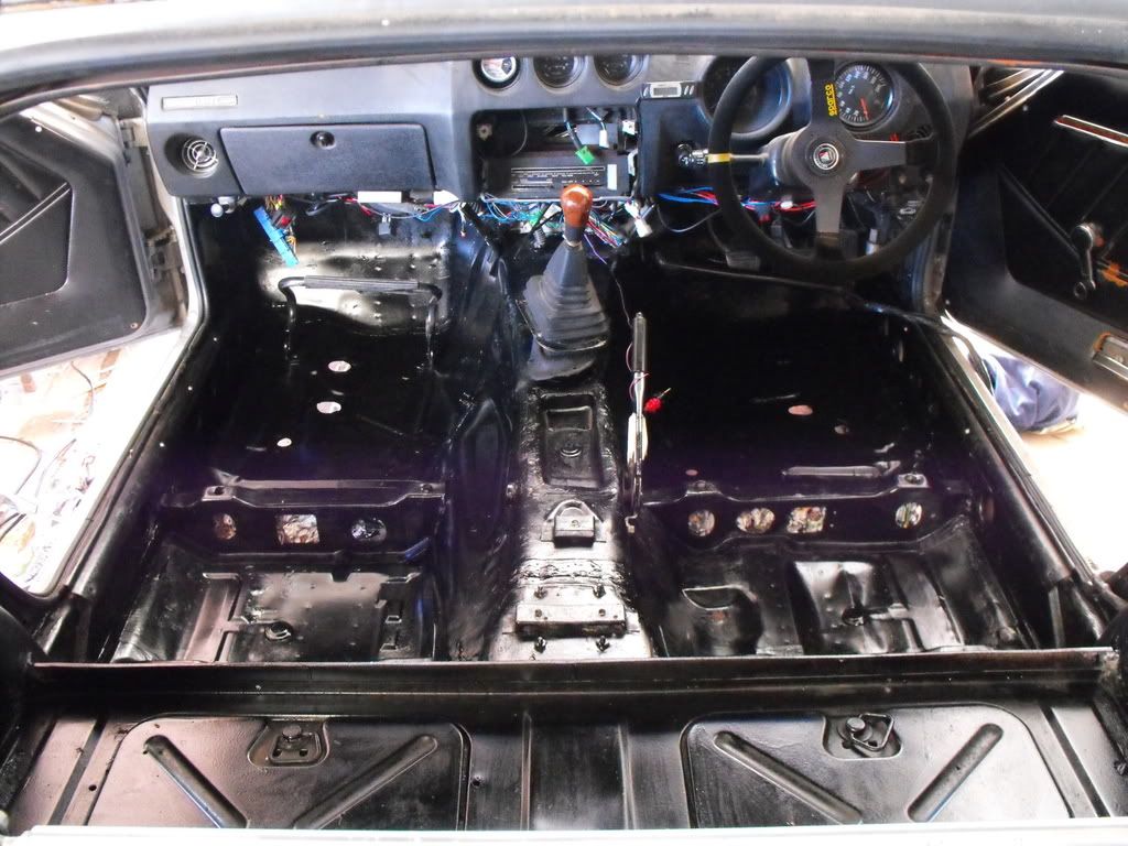

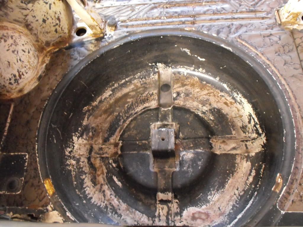

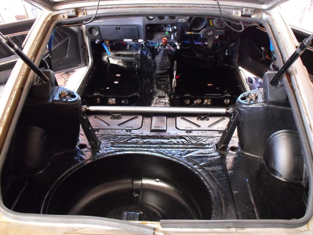

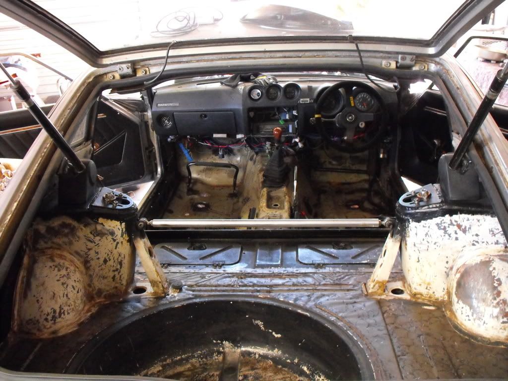

Well, I still havnt gotten around to doing the rear flares, I have never used bog and I don't want to learn :P, gonna have to.  In the mean time, instead of wasting time, I have stripped all sound deadening and carpets out.  I wanted to see if I had any rust, lucky me, barely anything.
So out came the drill bitt attachment for wire brushes, some Satin Black Rustguard paint and on it went.  I am going to do about 3 layers in the boot and 4 or 5 in the foot wells just cos they get used more.
Here are the results:
Before:
Posted Image
After:
Posted Image
Before:
Posted Image
After:
Posted Image
Before:
Posted Image
After:
Posted Image
It makes the rest of the interior look shit though :D  Meh, its gonna be raced, not shown off.

i see what you did twisting the gear boot around 30 degrees. Nice !!  ;D ;D ;D
Nah in seriousness looking really flat and race inspired. I assume therefore no dynamat or any of that sort of ish?
#46 sco_aus
sco_aus
  • 2,484 posts
  • Location:Canberra, ACT
  • Tagline:Scott
Posted 25 July 2008 - 12:41 PM
Nah, it will remain like this unless I get any problems, but I doubt it.  Hehe, I just couldnt be bothered removing the bloody thing, so I lifted it :D  I have just moved a few different things out of the way, like seat belts and a few wires, its not really meant to be that pretty, just wanted to make sure my foot wouldnt fall through a rusty floor at 200k/ph... :D

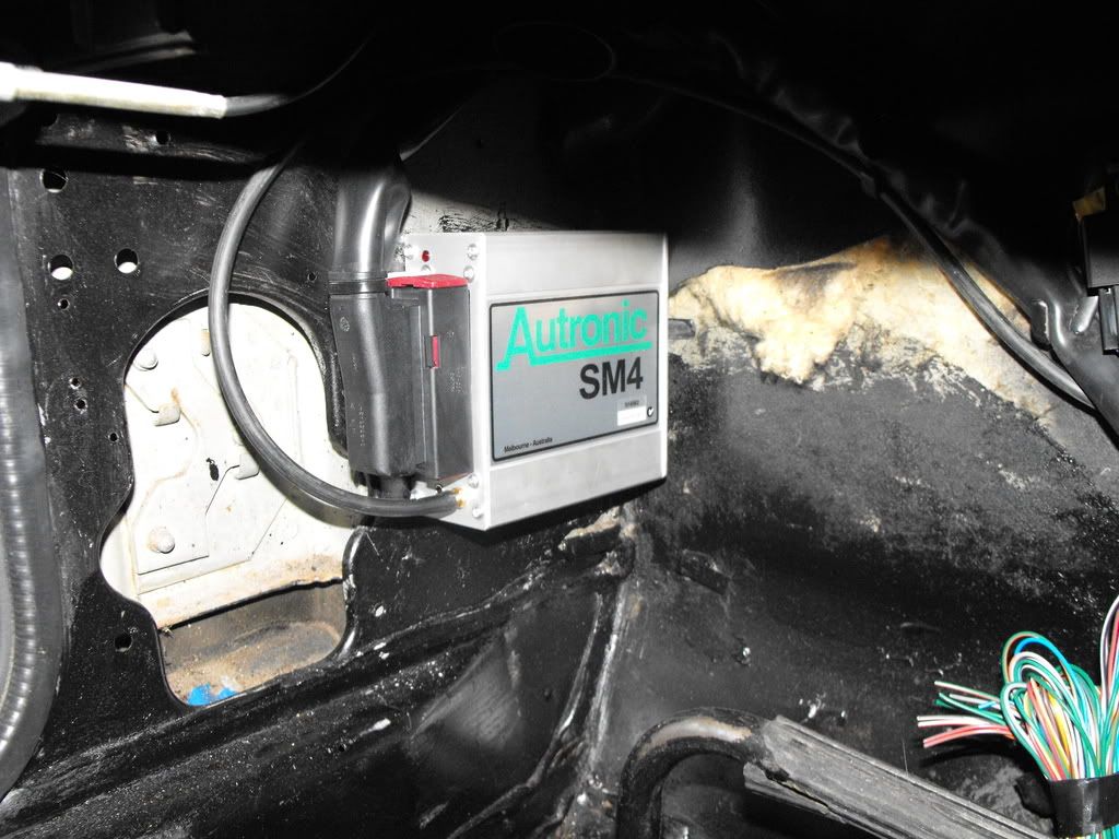

So here is the main item, the Autronic SM4 wired in:
Posted Image
Posted Image

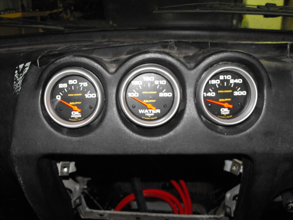

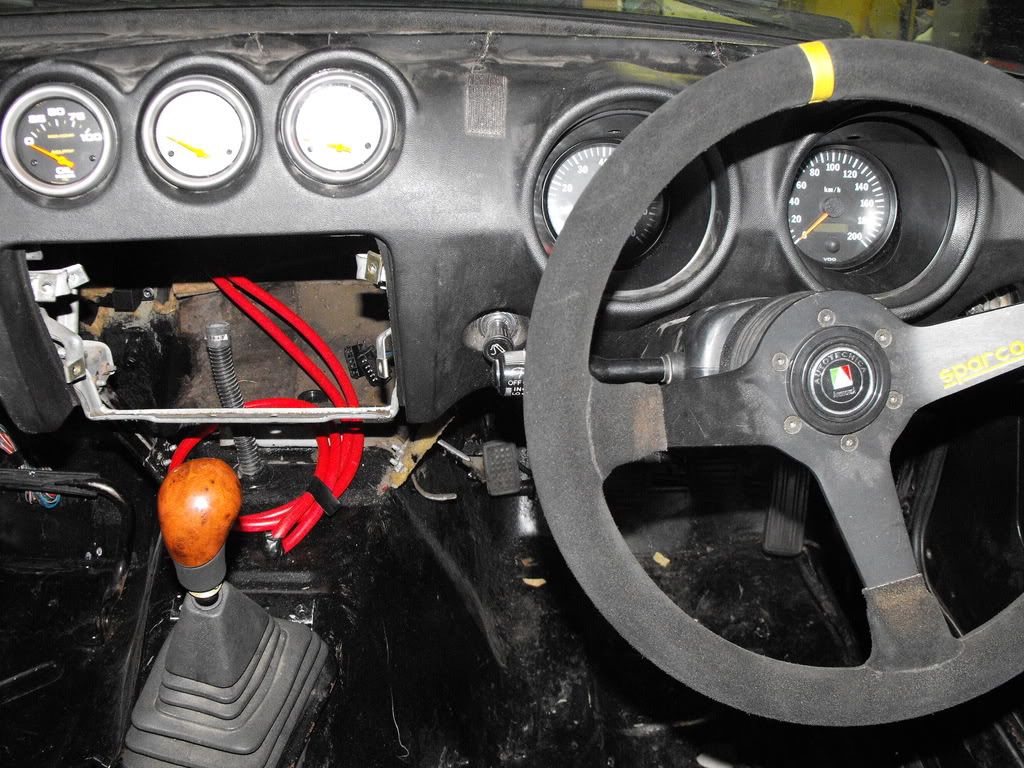

Here you can see the new Autometer gages and VDO speedo and tacho installed:
Posted Image
Posted Image
Posted Image

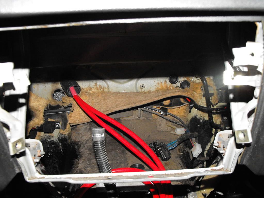

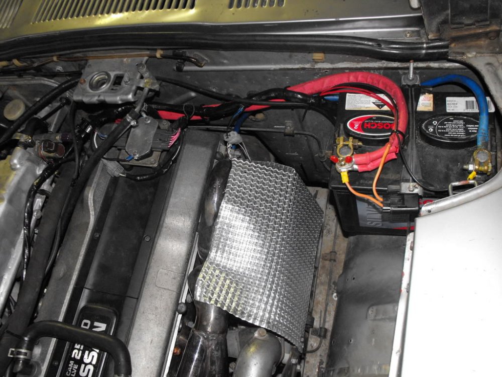

The blank area where the heater unit used to be will be replaced with a panel containing a battery isolator and a switch to turn on the 12V 2 stage heater i will install (plus any other items i decide to add later).  Note the red cable for the isolator:
Posted Image

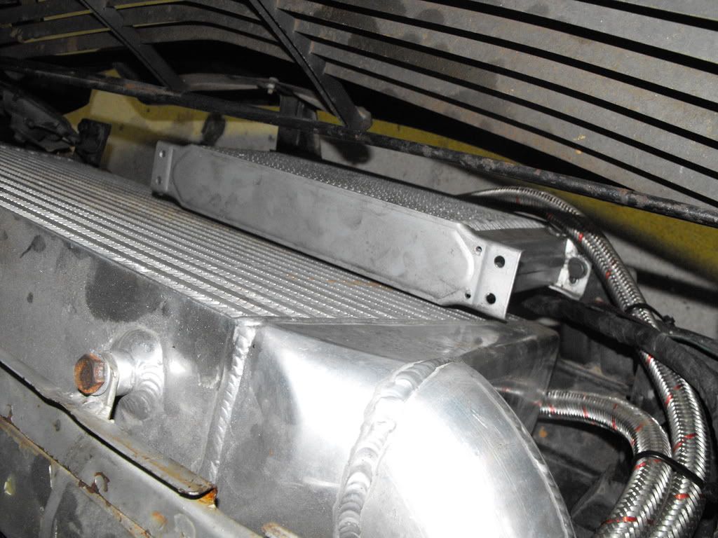

The oil cooler was properly mounted:
Posted Image

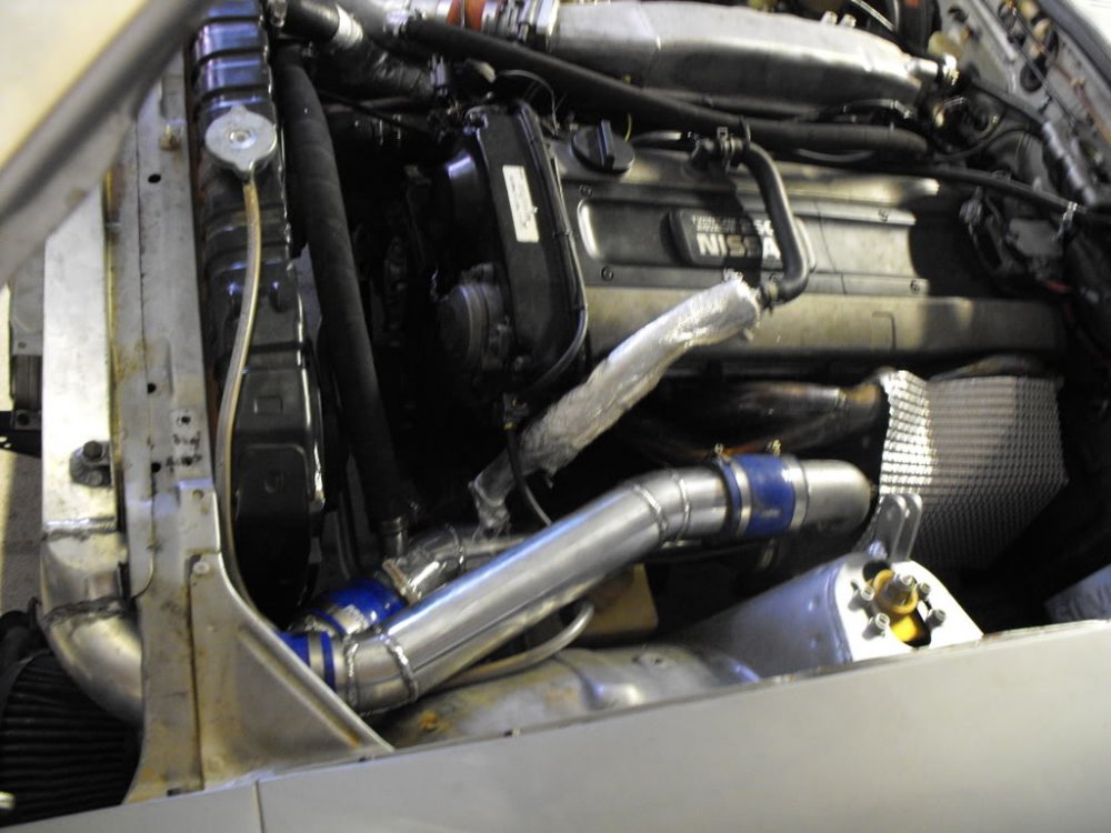

Here you can see new intercooler piping and a pipe underneath the cooler pipe that has moved the airfilter from behind the radiator to infront of it:

I am amased at how much room is under the dash once the heater unit is pulled out, crazy.  I call it the "boot" now.

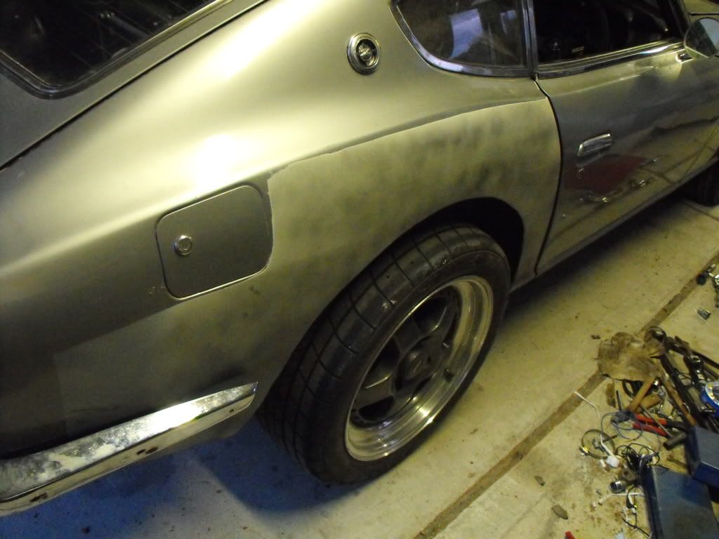

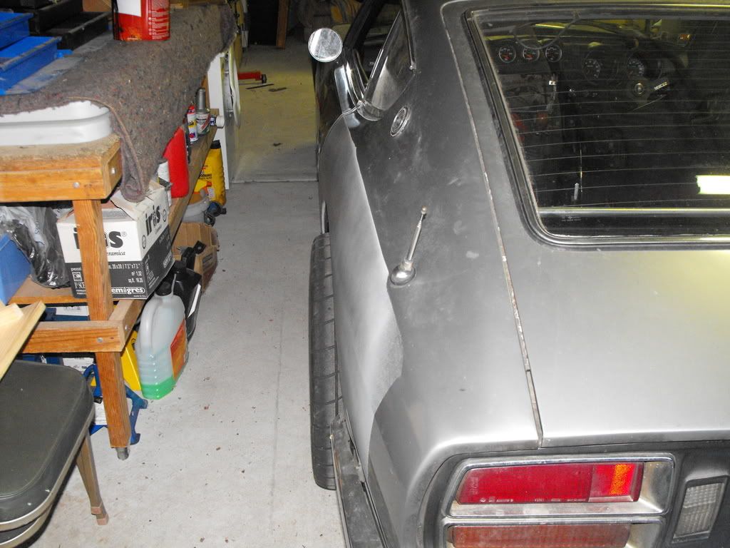

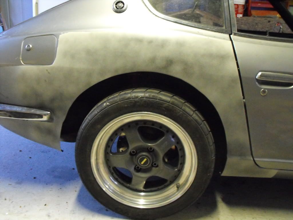

While I am at it, for those that saw my rear guards at the meet up in Woden not long ago, well here is the much improved version, just need to paint it and mount flares to have the exterior basically where I want it for a good few years:
They were fixed using a fibreglass compund or something like that, the guy did an awesome job, even smoothed the sharp edge running along the centre to make the top of the flare easier to mount flush.
Posted Image
Posted Image
This is why flares are needed :D :
Posted Image

#60 Zedman240®
Zedman240®
  • 5,198 posts
Posted 04 October 2008 - 01:25 PM
