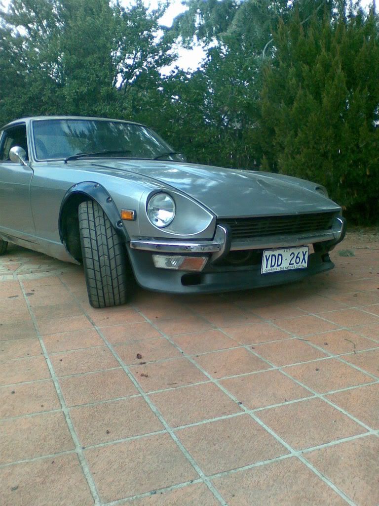

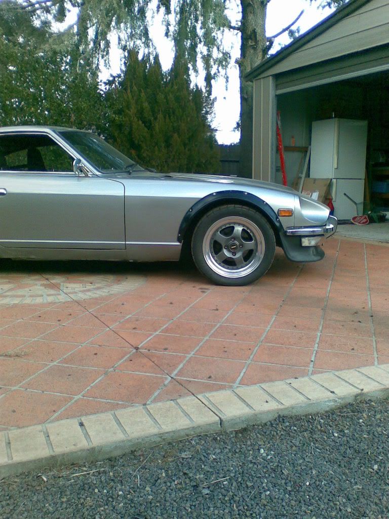

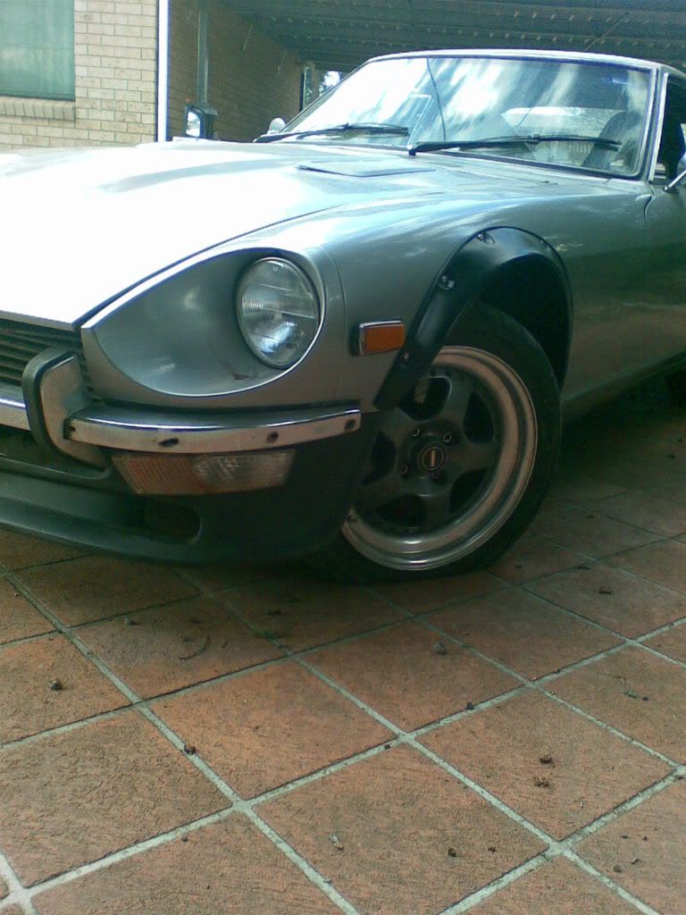

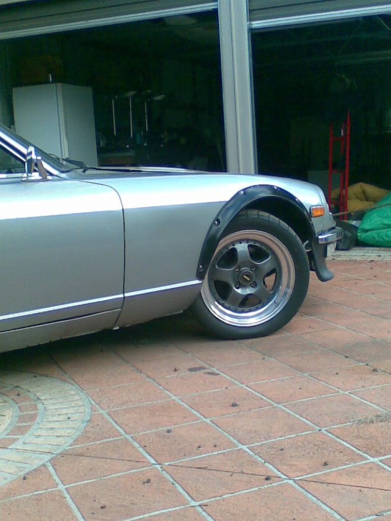

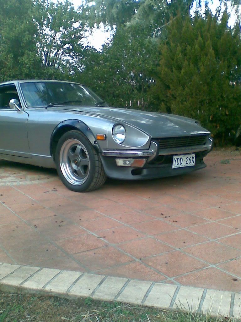

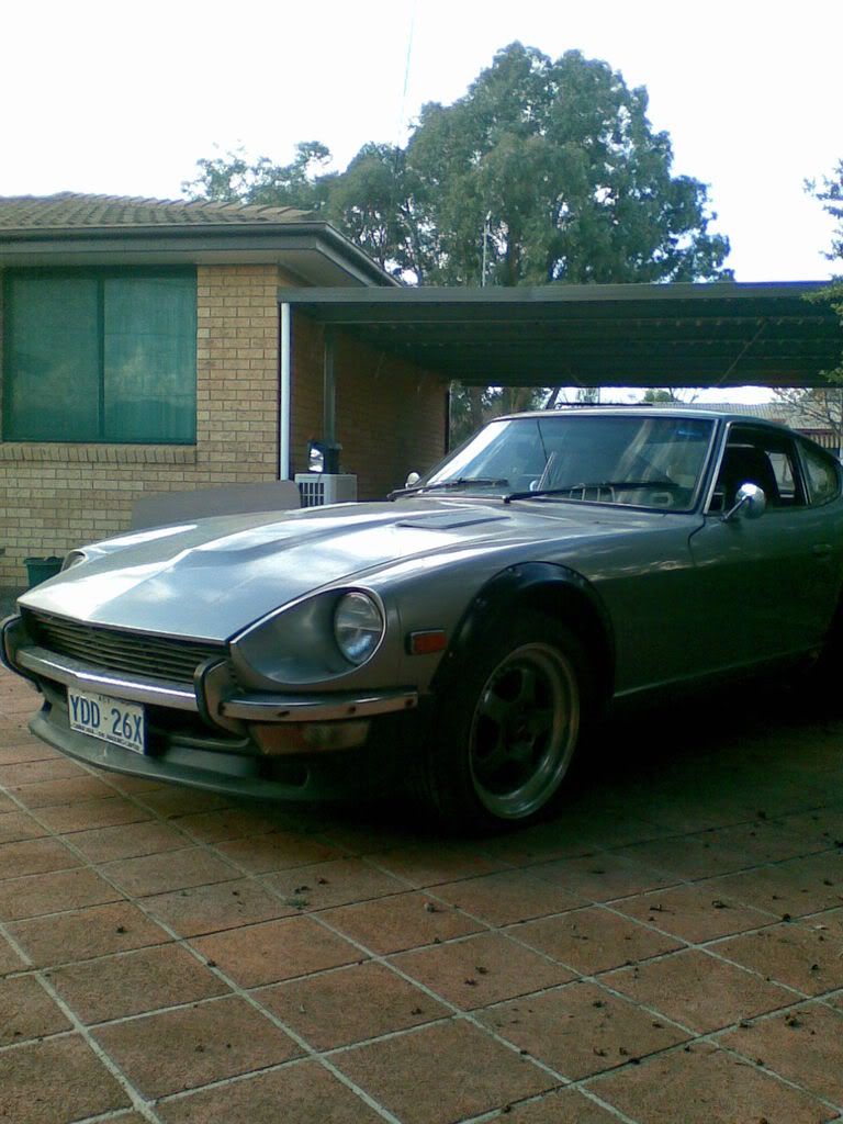

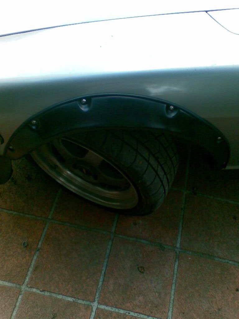

Well I have finally gotten off my lazy butt and started doing things.  Today I fitted the front flares with a lot of success owed to Austin Hoke's tutorial.
I am also coming upon a reasonable amount of money in June, so I will get the brakes sorted out and an alloy radiator (PWR 4 core(V8 supercar)) fitted.  If money still permitts, I will get a full CAMS roll cage done too.
Here are some pics of the front flares.  I really need to get some spacers :P
Posted Image
Posted Image
Posted Image
Posted Image
Posted Image
Posted Image
Posted Image
Posted Image
Sorry, a lot of pics, I know.

When you go to put on the back flares, make sure you take out the wiring harness on the drivers side so you don't drill through it like i stupidly did! lol, and remember, its alot easier to remount them higher than it is to remount them lower...
Also, instead of spaces wouldn't you be able to get new outter rim sections? i think its about $150 each, but since most jap cars seem to run rims of a similar width to what it looks like you already have at the front, you could always just leave the front as it is and just make the rear ones fat :)
