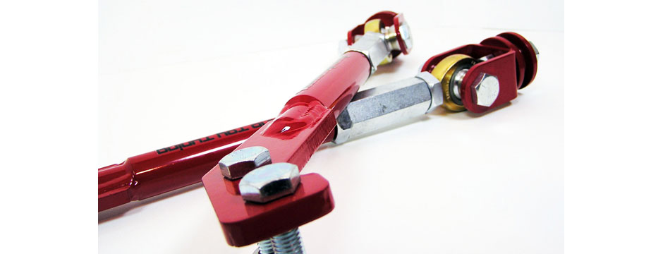

What type of rod end would you recommend for this application (size / type / etc ) ?
Its a radius rod for a 280ZX

1600Dave: 9/10 times you are limited in size and type by the bolt that will go through the eye and the thread type used in this assembly unless you want to re-engineer the part.
what i can tell you from this is it looks to be a male rod end with high angular capacity. there are 2 ways of achieving this either by a rod end with a specific ball type for high misalignment capacity or by using a standard one and putting spacers on either side of the ball. in essence i would try to fit in the biggest rod end you can with highest spec for load. then it comes down to budget too. wouldnt use anything less than chro-moly or high strength SS in this application. if you want the top end then design up a imperial thread to be used then you can put in the aerospace grade rod end like all the V8 guys do.

Thanks for the info ! Yep, I'll be making the whole assembly from scratch (including the bracket that it attaches to on the car) so re-engineering is quite possible.
