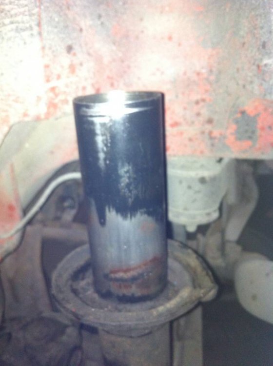

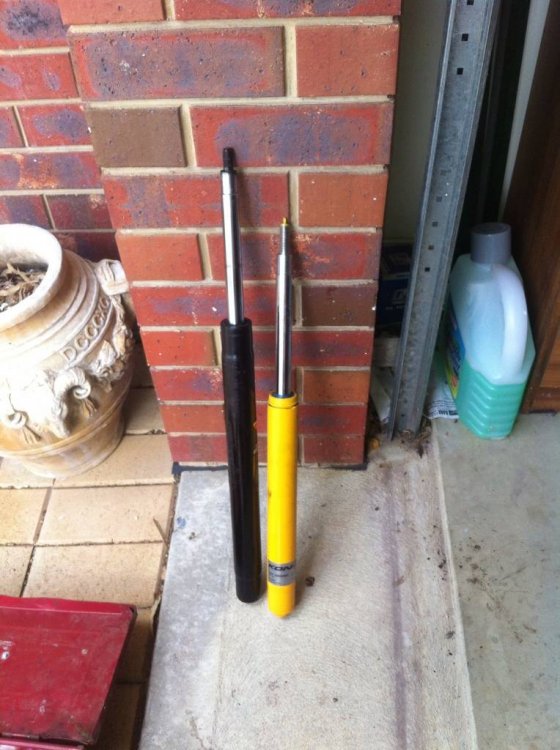

#4 JJ260z
JJ260z
    Member
  • PipPip
  • 23 posts
  • Location:Adelaide
  • Tagline:New Member
Posted 16 February 2013 - 05:15 PM
So pictures to help
Posted Image
Konis are the yellows obviously!!
And the strut tube.
Posted Image
Thanks in advance

You simply need to accurately measure the difference in height.  Then cut a peice of thick sided tube or solid rod that length and drop in in the strut tube before you put the insert in.  It is important that after the gland nut is torqued that there is absolutly no movement of the insert.
No they don't need to be modified at all.  For a 240 strut they need a little sanding of the paint to fit, but not for the bigger 260 struts.  You can fill the strut tubes with auto trans oil (obviously after you put the insert in) to help with heat dispersal.
100mm does seem a lot though.  Unless the 260 struts are a lot longer than 240's, it should really only about 24mm for the front and 57 for the back (from memory - don't quote me).  Put the strut together, push the insert to the bottom of the strut, mark the insert shaft with a fine point marker and then slid it up to the top (make sure the piston rod doesn't move) and then mark it again.  This will give you a pretty good 'guide' to how long the spacer needs to be.

My guess is they have given you front inserts and not rears. There is around 80 to 85 mm difference in length's from front to rear. You need to take them back and get the correct inserts . But I would take a measurement of the inside length of the strut and take your gland nut with you when you return them. Koni make a wide range to lengths you should be able to get something much closer to what you need and they should be able to supply spacers if required.

There is less oil volume in those Koni's, they will get hotter quicker, there will be higher volume of oil passing through valve, causing higher wear, and need to rebuild.
It will lose its efficiency.
Do not use thin type tube as a spacer, it will crush , ie exhaust pipe.
Some thick wall tube OD turned to fit ID of strut tube, and some hardened steel washers as packers.
If you are going to use these, ensure the stroke lenght is the same as the insert/wet leg coming out of your struts.
I'm thinking the guy in the Suspension shop has palmed off something that WILL fit, but is incorrect, just to get rid of them.
