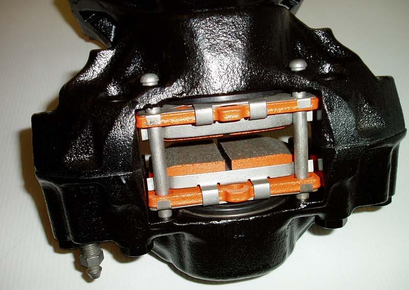

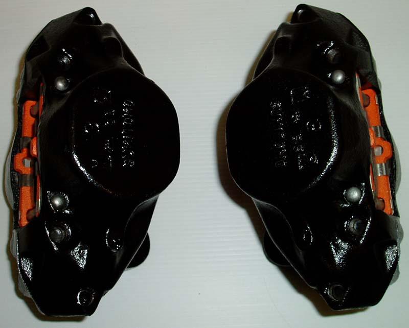

This article is a step-by-step guide to mounting the rear calipers & rotors from a R31 Skyline onto the rear of your 240/260Z.
The key to to this conversion is the correct preparation of the mounting brackets as this will take the most time.
It is also recommended that you recondition the calipers prior to use, fit new pads & rotors.
I would prefer to remove the hubs as cutting off the backing plates is tedious but can be done.
Items you’ll need:
R31 Skyline rear calipers and mounting brackets
(I purchased mine on ebay for $90)
R31 Skyline discs and brake pads
(New would be good)
Custom brake lines with a male fitting at one end and a female fitting at the other.
(These will need to be around 260mm long which is the same diameter as the disc)
The mounting bolts from your rear drum plates (3 of for each side)
The caliper mounting bolts from the R31.
I'll assume that you have a workshop that is equipped with drill, grinder, welder and hand tools and a level area of ground to work on.
Before you start:
You will need to weld up the original bolt holes in the R31 Mounting Brackets and have the centre machined out to 86mm.
Also have your custom brake lines made up (or you could take your Zed to have them fitted after but that may be a PITA)
You can see the complete kit below with the Brackets already customised ready for drilling and cutting.
