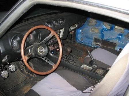

I saw this pic in the galleries of RBZ260's DIY dash reskin!? Any details on how you go about doing this at home and how much?????

The dash itself was a mess. i will put a pic of it when i started. it had 6 cracks accross, huge ones accross the 3 center pods gap of almost 2.5cm two other cracks on the speedo and tacho pods and a huge one accross the glove box lid. in other words it was CRAP.
